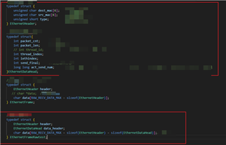

AM6442: ICSSG1 eth port receive length is increased 1532
Part Number: AM6442
icssg dirver: porting from uboot in sdk9.0
test method: phy internal loopback
compile chain: gcc
When testing RAW data, send 1024 bytes of data every 1ms, receive the data, and check the receive length, which can sometimes be 1532.
Read the statistics register of the MII_G module to show that the total data length received can be evenly divided by the length of each packet, that is, the length of the data received by the MII_G module is no problem.
There is a problem with the pru module receiving data and then transmitting it to DMA.
What is the cause of this problem and how can I solve it.

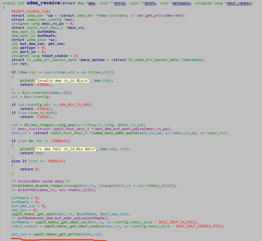

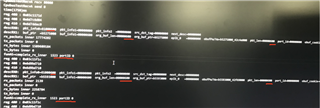

  • This is the record of cpsw network port driver test performance.
    The sending thread of board A binds core 1, and the receiving thread of board B binds core 1.
    There are no other tasks in the core 1 of the two boards, and there are still length anomalies in the long-term test.
    When pkt_len is detected in udma_receive as 1536, the descriptor information is printed as shown in the figure above.
    The length in the log display descriptor is 1536(0x600).
    In this case, the cpsw receiving port number is 0, which is normally 1 or 2.
  • When pkt_len is detected in udma_receive as 1536, the descriptor information is printed as shown in the figure above.

    cppi5_hdesc_get_pktlen() return 1536.

  • The above picture shows the contents of the descriptor printed in udma_receive during normal communication。

    pkt_info1, pkt_info2 ,src_dst_tag  is not zero。
    When the receive length is abnormal, these values are 0。

  • yes,the schematic diagram is   [BOARD A  cpsw---phy]--- [phy----cpsw BOARD B]
    the ethernet frame like the below figure
  • this is  our udma receive funciton

  • In udma_receive(),
    invalidate_dcache_range((ulong)desc_rx, (ulong)(desc_rx + ucc->hdesc_size));
    There's something wrong with this?
    The range of parentheses in the code is wrong ?
    It should be invalidate_dcache_range((ulong)desc_rx, (ulong)(desc_rx ) + ucc->hdesc_size);
  • invalidate_dcache_range((ulong)desc_rx, (ulong)(desc_rx + ucc->hdesc_size));
    -->  invalidate_dcache_range((ulong)desc_rx, (ulong)(desc_rx ) + ucc->hdesc_size);
    I modified the code according to the above post, tested for 12 hours, and the problem did not appear. Without modification, 4-5 hours of testing will definitely occur.
    The problem solved.
    Thank all of you!
