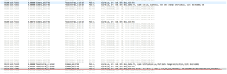

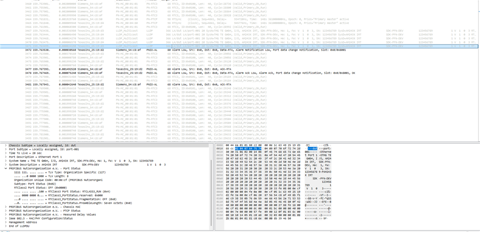

My company is developing a Profinet IO IRT device with the AM335X board. The profinet stack version used is the 5.9.0
When we execute the official test tool for IRT (SPIRTA) there is a random error but quite repeatable in which a DHT alarm is triggered unexpectedly. The error can appear in any test where RTC3 packets are sent by the master and the slave.
The following picture shows how the master is still sending IO messages but the DHT alarm is sent.
Notice that there was a port data change alarm in some packets before. The port reports that it is in OFF state when it should be in RUN.
I am guessing that there is some kind of integration issue affecting the timings or the tasks behavior, but I don't know how to debug it. I tried deleting almost all of the application's code but the issue still appears.
Do you know what might be causing this issue?

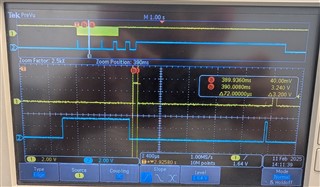

  • Adding a bit more context, I used some GPIOs to track some of the interrupts (ppm, cpm, etc) when the issue is reproduced. In the following image, the yellow line shows when the program enters and leaves the PN_cpmIsrHandler, while the blue line shows the same but for the PN_ppmIsrHandler
    As you can see, it looks like the ppm isr is getting blocked somehow, but I couldn't find what is blocking it. Apparently, it is not blocked by the code inside the ppm isr function

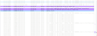

    Just to add another note, I have noticed that sometimes the slave never sends cyclic messages after the initial negotiation:
    Luis
  • Hi Luis,
    For IRT communication, there might be a slight delay after initial negotiation and the communication will only start after the "RTClass3_portStatus" is set to "RUN" in the DUT. Are the cyclic frames never sent after the initial connection?

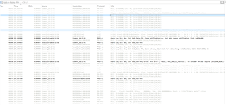

  • Hi Laxman,
    I checked further the capture and indeed the frames are sent when the port status is changed to RUN, but a few packets later, the port status changes again to OFF and the slave stops sending packets
    Later, the slave reports again a port state change to RUN, but it does not send RTC3 frames. Then the DHT/WDT alarm is triggered
    These screenshots were taken using the PerformanceIndicatorCheck01 test case.
    I am attaching some captures of some failed test cases. The error is apparently the same in all of them

    In the meantime, I would like to focus on what might be blocking the PPM interrupts (see the screenshot I sent in the second message), I have tried to use GPIOS to identify in the oscilloscope what other Hwi might block the isr handler, but I haven't found it. Do you know a way to investigate that more effectively?
    Thanks for your help,
    Luis
  • Hi Luis,
    Looking at the oscilloscope display, most likely the issue seems to be caused due to an interrupt of higher priority blocking the CPM and PPM ISR. We will review the interrupt priorities and provide an update.
