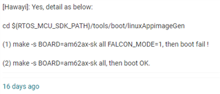

[Hawayi]: Yes, detail as below:
cd ${RTOS_MCU_SDK_PATH}/tools/boot/linuxAppimageGen
(1) make -s BOARD=am62ax-sk all FALCON_MODE=1, then boot fail !
(2) make -s BOARD=am62ax-sk all, then boot OK.

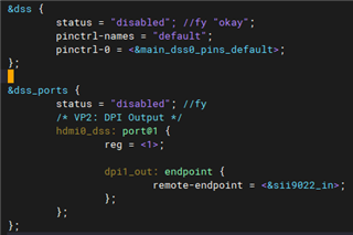

    Just for debugging, can you please try to disable the "&dss" node in kernel devicetree to see if the boot issue still happens? There is an known DSS issue in SDK10,0 which could trigger the rcu preemption stall problem. I am just not sure how this would be related to the 2GB DDR configuration though.
  • Could you have a try on the EVM?
  • Have you tried it and what is its result?
    I only support Linux and am not familiar with SBL. Prashant has been tied up to another work and doesn't have time in the next few days to test this on EVM.
  • Can you git a patch to disable the "&dss" node? Is correct show below? We have disabled it for a long time.
