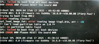

Customer's board boot failed.
error log as below
This is base on SD-BOOT.
What's possible reason caused "error reading cluster" & "spl_load_image_fat failed"?
I think this error happens in tiboot3.bin, isn't?
Need debug suggestion
Thank You.

  • Hi Gibbs,
    The issue is that tispl.bin is not coming up.
    Can you help me with a couple of questons:
    • Are you using a custom board or TI EVM.
    • Which linux SDK(version) are you using?
    • What are the boot switch settings ?
    • Are you using the prebuilt binaries?
    • What are the steps you followed to copy to SD CARD
