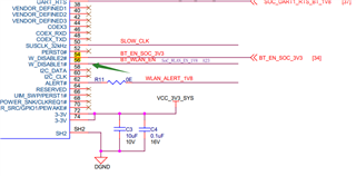

problem description:
  • I tried to use the AP6275S WiFi module and found that the pin of WLAN EN could not be pulled up
My Settings:
        wlan_lten: regulator-6 {
                compatible = "regulator-fixed";
                regulator-name = "wlan_lten";
                regulator-min-microvolt = <3300000>;
                regulator-max-microvolt = <3300000>;
                vin-supply = <&vcc_3v3_sys>;
                gpios = <&exp1 11 GPIO_ACTIVE_LOW>;
        wlan_en: regulator-7 {
                regulator-name = "wlan_en";
                regulator-min-microvolt = <1800000>;
                regulator-max-microvolt = <1800000>;
                vin-supply = <&wlan_lten>;
                enable-active-high;
                gpios = <&main_gpio0 71 GPIO_ACTIVE_HIGH>;
                pinctrl-names = "default";
                pinctrl-0 = <&wlan_en_pins_default>;
