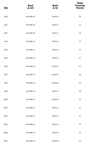

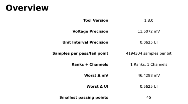

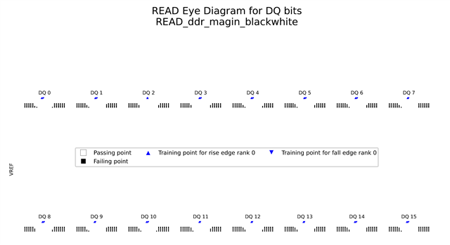

AM6421: Confirm the test results of DDR margin.
Part Number: AM6421
Based on the firmware provided by TI, we have conducted tests on our board and would like to help confirm whether the test results are qualified.

                         DDRSS "Teye" Tool
                         Version 1.8.0
    Jacinto created and Sitara iterated toolset across SoCs and platforms
    Tool only supports LPDDR4
    Tool expects the MMU/MPU properties for:
            DDR SDRAM region to be WBWA cacheable
            DDR CTRL region to be Device/Strongly-Ordered memory
    Tool does not comprehend margins across chip selects and only does current controller set point
    TEYE_TOOL_START
    SOC Type=AM64x
    Detecting user configuration and saving important parameters
            DETECTED: DDR Instance is DDRSS0
            DETECTED: DRAM class: 0xb == LPDDR4
            DETECTED: Bus width: 16 bits wide
            DETECTED: Burst Length is 16
            DETECTED: Ranks: 1
            DETECTED: Channels: 1
            DETECTED: Physical chip selects: 1
            DETECTED: Frequency sets: 2
            DETECTED: DRAM FSP 0 is programmed to controller frequency set 2
            DETECTED: DRAM FSP 1 is not mapped to any controller frequency set
            DETECTED: Current FSP in DRAM is 0
            DETECTED: Current controller frequency set is 2

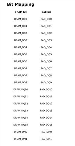

            DETECTED: Bit Swizzling as follows:
                    SoC Pad   = DRAM
                    PAD_DQ0 = DRAM_DQ0
                    PAD_DQ1 = DRAM_DQ1
                    PAD_DQ2 = DRAM_DQ2
                    PAD_DQ3 = DRAM_DQ3
                    PAD_DQ4 = DRAM_DQ4
                    PAD_DQ5 = DRAM_DQ5
                    PAD_DQ6 = DRAM_DQ6
                    PAD_DQ7 = DRAM_DQ7
                    PAD_DM0 = DRAM_DM0
                    PAD_DQ8 = DRAM_DQ8
                    PAD_DQ9 = DRAM_DQ9
                    PAD_DQ10 = DRAM_DQ10
                    PAD_DQ11 = DRAM_DQ11
                    PAD_DQ12 = DRAM_DQ12
                    PAD_DQ13 = DRAM_DQ13
                    PAD_DQ14 = DRAM_DQ14
                    PAD_DQ15 = DRAM_DQ15
                    PAD_DM1 = DRAM_DM1
    Teye_eye_type=READ

  • Hi Lucas,
    I apologize for not understanding your intention at the beginning.
    Now, I have generated the result based on the full log.
    Could you please help me confirm whether the result is normal?
    ddr_magin6.pdf
    BR
    Ryan
