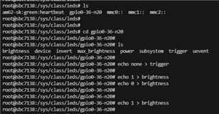

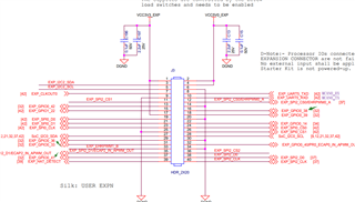

     There are problems when trying to test GPIO N20, M21 and V25.
     GPIO set output mode, set 0/1, the measurement found that the level does not change;
     GPIO set to input mode, external intervention high/low level, read value will not change.
My Operating:

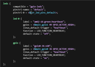

 My dts :
    In the device, you'll need a reference node. See this thread for an example:  https://e2e.ti.com/support/processors-group/processors/f/processors-forum/1268671/sk-am62-using-the-gpios-in-the-40-pin-user-expansion-port/4804378
    Or see something like this:

      I think it is not the problem of the device tree. The way of enumeration of the device tree is the same as that of my operation in the led node now. It should be my wrong calculation of the pin number.For example, I want to pull up m21 pin, the implementation of the echo 0 > / sys/class/gpio/gpio440 gpio440 / value but this may not be m21 pin, so I want to know how the gpio number calculation
    • It is true that my pin number was miscalculated, and now the problem has been solved
