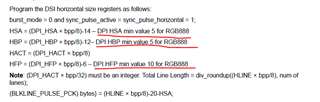

In the dss_dctrlDsi.c file we noticed following code block (function dssDctrlUpdateVideoSizeConfig)
We have set vFrontPorch to our forwarded value, and VSync is detected.
But for the hSync apart from multiplication with BPP, additional values are used: 14,12,6,20.
Can you explain these values, and how are they calculated?
horzTotal = mInfo->width + mInfo->hFrontPorch + mInfo->hBackPorch + mInfo->hSyncLen;
dsiObj->videoSizeCfg.vact = mInfo->height;
if (DSS_DSI_CONNECTION_DSI2DP_BRIDGE != connectedTo)
dsiObj->videoSizeCfg.vfp = 1;
else
//We have forced entering here, even we do not have DSI2DP bridge
dsiObj->videoSizeCfg.vfp = mInfo->vFrontPorch;
dsiObj->videoSizeCfg.vbp = mInfo->vBackPorch;
dsiObj->videoSizeCfg.vsa = mInfo->vSyncLen;
dsiObj->videoSizeCfg.hsa = (mInfo->hSyncLen * BPP) - 14U;
dsiObj->videoSizeCfg.hbp = (mInfo->hBackPorch * BPP) - 12U;
dsiObj->videoSizeCfg.rgb = mInfo->width * BPP;
dsiObj->videoSizeCfg.hfp = (mInfo->hFrontPorch * BPP) - 6U;
dsiObj->videoSizeCfg.blkLinePulsePacket = (horzTotal * BPP) - 20U - dsiObj->videoSizeCfg.hsa;
Do you have other idea, what we can check and what might be wrong?
