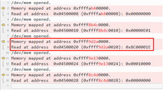

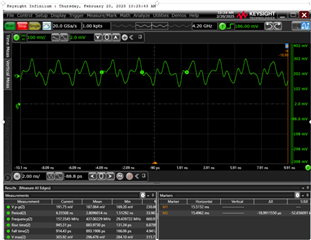

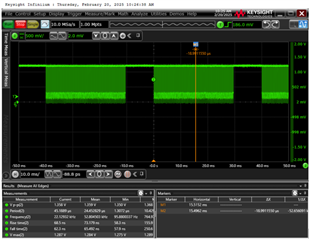

  Now we have a problem where the deserializer MIPI-tx has data to send, but MIPI-RX does not receive data。
 1. IssSensor_CreateParams config
2. Measurement of the MIPI-TX clock waveform
3. Measurement of the MIPI-TX lane waveform
4. read regster 0x04504020  =0x63
我提供以上测试信息,麻烦给一下解决问题的建议

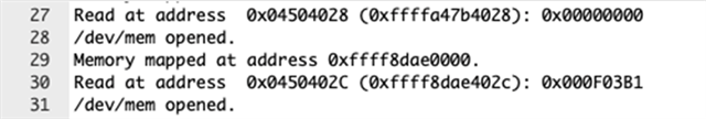

  • Hi Brijesh,
    Update the latest test:
    1. Below is the register difference compared with normal scenario.
    The read value of DPHY_RX_MMR_SLV register is always changing.
    Could you please help check that Rx didn't receive packet or it received the wrong packet?
    2.
    The signal and timing is same with the normal Serdes;
    3.

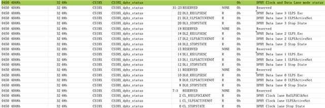

    We config MIPI TX 4lane, 2.2Gbps/lane, how should we select  CSIRX_LANE_BAND_SPEED?
    4.
    Is there any register in MIPI RX that can be used to record packet counter? If yes, can we use this register to check if DPHY link is OK?

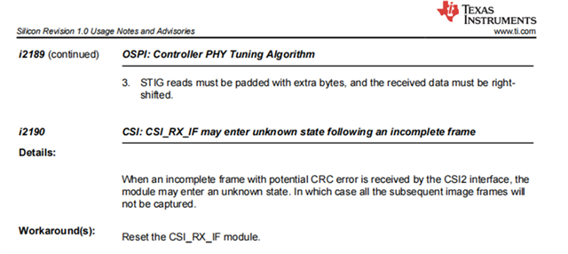

  • We do not enable the deskew calibration, due to captured the waveform of deserializer Maxim96722 + TI soc, there is not deskew calibration pattern outputting from Maxim96722, display is ok.
  • At such high speed transmission, deskew calibration output is required, so can be you please enable it in deserializer and check the output?
  • Hi Brijesh,
    We compared the MIPI Tx waveforms of our deserializer and Maxim96722, the timing of TLPX/THS-PREPARE/THS-ZERO/THS-SYNC/THS-TRAIL are matched.
    Dumped the TI SOC CSIRX register, did not find abnormal, please help to confirm.

    Also, checked below CSIRX registers value, we consider that the DPHY link is fine now, but do not clear why CSIRX still cannot get video stream, could you help to confirm the status of CSIRX? Thanks.
    1) readback 0x04504048, the value keeps changing from 0x0033306  to 0x0022206
    2) readback 0x04580B00, the value=0x00000252
    3) try to reset CSI_RX_IF module by setting 0x04504100 bit4, get the same results.
    because we find below issue in Errata.
    4) readback CSIRX_error_irqs register, the value=0x00.
    5) readback CSIRX_dphy_err_status_irq register, the value=0x00.

    But this means data is being received by CSIRX. Is CSIRX configured correctly with data type and virtual channel id? Can you please read  CSI_RX_IF_SHIM_DMACNTX register to confirm the same?
    Brijesh
  • Hi Brijesh,
    Thanks for your reply.
    CSI_RX_IF_SHIM_DMACNTX, 0x04500020 = 0x8C00001E, virtual channel=0, data type=0x1E.
  • Hi Ming
    Datatype is set to YUV422, is it correct? How many channels are you trying to capture? Do you have CCS + JTAG on this board? I want to put breakpoint on few APIs to see if it is getting hit.
    Brijesh
  • Yes, Data type=0x1E, it means YUV422 8-bit. we are trying to capture one channel.
