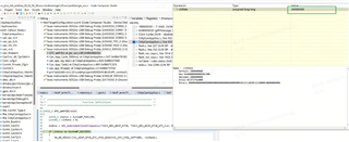

  • Hi Anil
    I would like to ask, how can I use the GTC timer to measure time? Can you share with me which steps to follow? What actions should I take to provide you with more information?
    BR,
    Huang

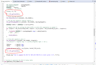

  • Hello Huang ,
    You can enable GTC form syscfg and generate the code in WKUP R5F core.
    Later, flash the updated WKUP R5F application in the SOC and next simply read the GTC count value from the MCU R5F core with the help of
    GTC_getCount64 API.
    Make sure that you need to run this test case in the release mode and not in the debug mode.
    This GTC count value needs to be converted to sec. For that please follow the steps below.
    Put the break point in the function below and get the frequency of the GTC timer.
    Next , To calculate Time = (T2 - T1 ) / GTC Clock frequency
    Anil.

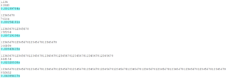

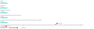

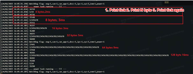

  • Hi Anil
    I obtained the clock frequency by interrupting as shown in the figure:
    Here are my test results:
    I hope the above information can help you analyze. If there is anything else you need to provide, please let me know.
    BR,
    Huang
