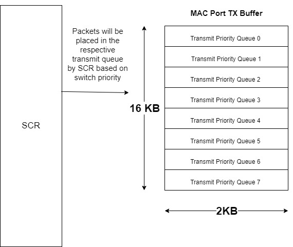

    Consider a case that I have allocated 16 KB for Tx MAC Port Buffer. and I have allocated 2KB for Tx Priority queue 0.
    Is the remaining size allocated for Tx MAC Port Buffer is now 14 KB (16 KB - 2 KB) or Tx MAC Port Buffer is still 16 KB and it is not related to the size of Tx Priority queues?
    Tx MAC Port buffer is 16KB, CPSW don't have individual configuration of queue for each priority as mentioned in E2E specified above.

    How 16 KB of  Tx MAC Port Buffer is distributed across Tx Priority queues (0-7)? Is my understanding shown below with the help of diagram correct about distribution of Tx MAC Port Buffer is distributed across Tx Priority queues (0-7)?
    Yes. your understanding is correct.
