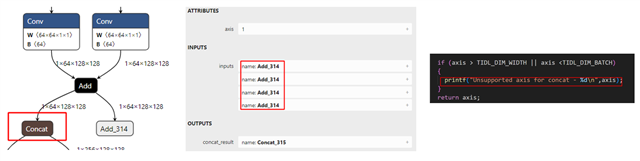

TDA4AH-Q1: axis value of the concat layer with a specific structure will be changed to -1 in SDK9.2
Part Number: TDA4AH-Q1
The sdk version I use now is  ti-processor-sdk-rtos-j784s4-evm-09_02_00_05
We have found that issues arise during model conversion when the inputs to the concat layer come from multiple copies of the same output. As shown in the figure below, the axis value will be changed to -1 during model conversion
