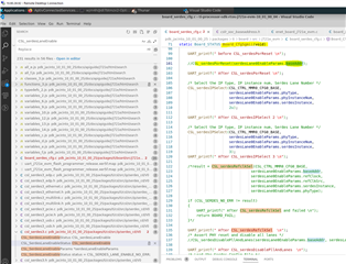

          Also observed that whenever we tried to access the base address CSL_SERDES_10G0_BASE then core was freeze means is it something related to access issue or MPU issue, if yes how can we solve this ?
    #define CSL_SERDES_10G0_BASE             (0x5050000UL) )
    From the below Image which function is accessing this address that time software stuck there.
    Satya.
    It means SerDes Modules is not enabled.
    Can you please confirm have you updated ethfw/utils/board/src/j721e/board_j721e_evm.c file with the required SerDes configuration like clock configuration and power on the module?
    Please cross with changes made in SDK 7.3.
    Sudheer
