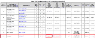

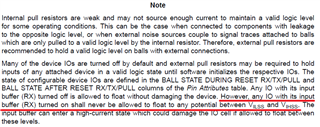

1) There is something which is not clear about MMC0_CLK recommandations:
When looking at the datasheet (2024) table 5-80 one can read the following :
==> MMC0_CLK can be left open when not used
But on page 94 there is a note specifying some case where external pull is required:
The problem is that MMC0_CLK is also described in table 5-1 as being RX : ON after boot without any internal pull inside. This would therefore require an external pull when not used.
Is there something I am missing ?

  • The MMC0_CLK pin will be driven low as soon as power is applied, so no concern with the associated input floating.
    Your concern with respect to the I2C0_SCL pin is already addressed in the Connectivity Requirements table. Note: The description for the I2C_SCL connectivity will be updated in the next revision of the datasheet to include the option of pulling the pin high or low, by saying, "Each of these balls must be connected to the corresponding power supply or VSS through separate external pull resistors to ensure the inputs associated with these balls are held to a valid logic high or low level as appropriate for the selected signal function."
