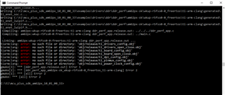

I am encountering the following error when I try to compile the SDK binary to flash the SoC.
gmake -sj4 all

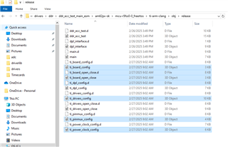

I followed the directions at AM62Px MCU+ SDK: EVM Setup. I do see the obj files in the obj/release/ directory.
Is it a path change from the original directory?
