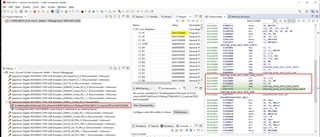

TDA4VM: TDA4VM MCU1_0 startup issue in PDK10.1
Part Number: TDA4VM
backgroud: SBL: PDK8.4 MCU1_0: PDK10.1
issue: The MCU can not boot that loop in brsStartupZeroInitLoop() in  .asm file, as the follow photo:
We found that the MCU1_0 enter point address is not right with the SBL. Any idea?

[20250301 14:24:36-560ms]Setting entry point for core 8 @0x41cb3a00

[20250301 14:24:37-261ms]Sciclient_procBootSetProcessorCfg, ProcId 0x1, EntryPoint 0x41cb3a00...
[20250301 14:24:37-321ms]Sciclient_pmSetModuleClkFreq, DevId 0xfa @ 1000000000Hz...
[20250301 14:24:37-385ms]Copying first 128 bytes from app to MCU ATCM @ 0x0 for core 8
