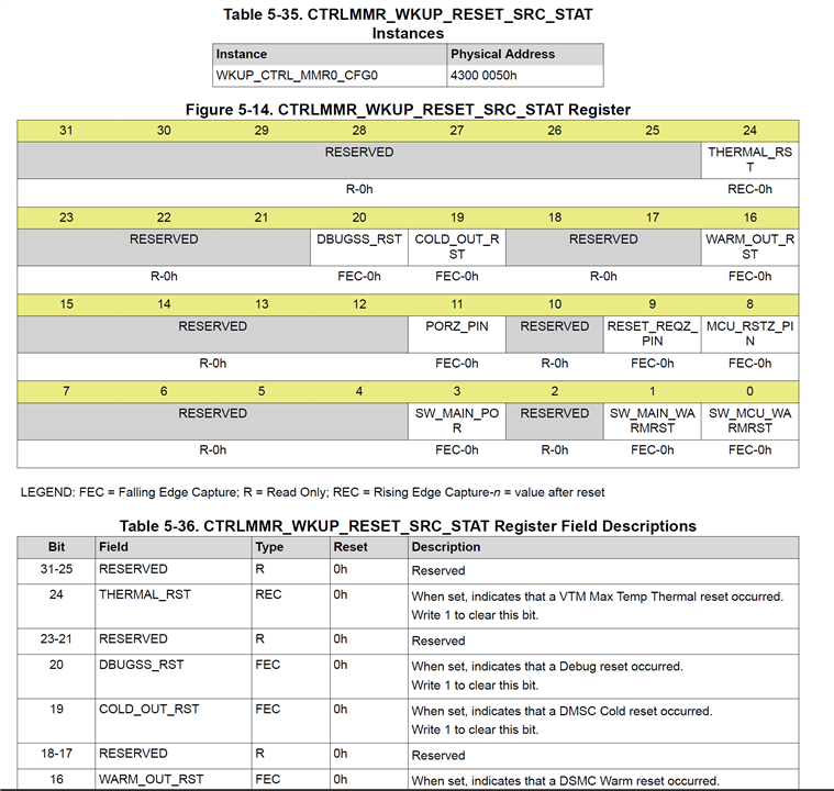

We buy the J721EXSKG01EVM  board and got at 2025/3/3.
Due to the mission requested, we need to work at  85 degree C.
and i issue command as memtester 900M 999.
it seem can not work smooth. it always reboot.
I check your user guide roughly, it seem not focus on the temperature tolerance.
Could you help to explain ?
