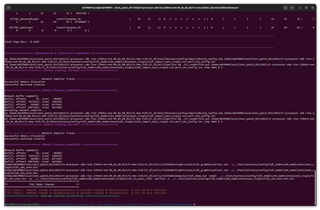

  • Hi; I understood and I ran the model-import the same way as you did. Here is the log file from my running.
    Please let me know whether or not this matched with your running.
    We will continue the next step to the patch version.
    Thanks and regards

    I was able to create a patch version of SDK 9.2. And with that, I successfully imported your model without any error. I will contact our local FAE to present my results, and make sure everything is OK. They will communicate with you if you have question. And then we will close this ticket.
    Screenshot is the result when I was running the model import of the patch version.
    Thanks and regards
    Wen Li
