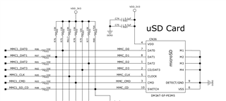

I am booting an custom am5728 board,i am facing problem as shown below where i feel the u boot isn't switching from 1 bit mode to 4 bit mode.

  2. This is not a software problem as other boards boot with the same SD card and only few boards face this issue. Could you give an idea on where to check in the hardware section to solve this issue.
    I have checked all these resistors and the clock signal and cmd signal which show a pulse in the starting, also dat0 line shows a pulse as soon as we power on the board.
    Could you help me check anything else in the hardware section that might be involved and might be faulty at the moment.

    Can you share schematic layout for the custom board to help debugging?
    Matt
    The schematic is fine and follows the same as the evm board for PMIC , SD card and DDR section.As i had mentioned only some boards i face this issue and i am confused on where to see for debugging.

  • When interfaces work on some boards but not others - can sometimes indicate a design parameter (voltage level, timing margin, etc) is marginal.  Have you checked to make sure both high and low IO levels are correct.  When Uboot switching from 1b to 4b mode, is speed also changing?  Does slowing down the interface help?  Could be a timing parameter is not being met.  The PCB implementation can impact signal quality - if it is creating reflections.
    Manufacturing errors can also cause some boards to work, others to not work properly.
    we did try these and it did not solve the issue , we traced the issue on the cmd line and data 3 line which were shorted and caused the issue of the error to come.
    but we are still not able to trace where the problem is for the board where nothing comes up as there is no short on the data and cmd lines.
    Should we check the RAM termination resistors , does it get involved before the  uboot loads??
    If not could you let us know from where can we start the checks?
    Roshan Rajagopal
  • If I understand correctly - one board that was failing was due to manufacturing issue.  It is possible the other board is also a manufacturing issue also, maybe just a different issue.  Opens are also possible (no solder connection)
