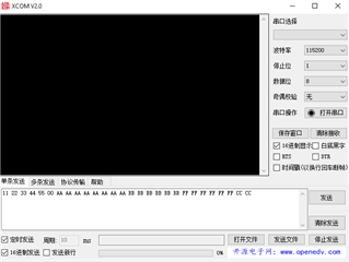

If the Rx & Tx of UART is not the same time, then this problem is hard to reproduce (need more than 1 hour running to reproduce). To make it easier to reproduce, customer found the following two methods.
1: Rx & Tx at the same time.
2: Tx & Rx with different baud rate.
The running method is below.
1) Use the following CSerial.app & CSerial.h to compile the RS485DeviceTest, running on the AMM335.
CSerial.cppCSerial.hhttps://e2e.ti.com/cfs-file/__key/communityserver-discussions-components-files/791/RS485DeviceTest
2) Use Windows Uart tool shown below to send 20+ bytes data every 10ms, and after 5 minutes they could reproduce the problem.  (if Rx & Tx at the same)
3) The error log is shown below.

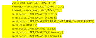

We could clearly see that Omap8250_IRQ is frequently entered when problem happens.
Testing Tried
To try solve this problem, customer found a very similar thread which also discussed this problem before. Only difference is that this thread is for AM62x.
https://e2e.ti.com/support/processors-group/processors/f/processors-forum/1369395/sk-am62b-serial-8250-8250_omap-fix-possible-interrupt-storm-on-k3-socs/5342236#5342236
And customer has tried the workaround discussed in the above thread but still not solved the problem yet. (code below)

       * On K3 SoCs, it is observed that RX TIMEOUT is signalled after
       * FIFO has been drained or erroneously.
       * So apply solution of Errata i2310 as mentioned in
       * https://www.ti.com/lit/pdf/sprz536
       if (priv->habit & UART_RX_TIMEOUT_QUIRK &&
           (iir & UART_IIR_RX_TIMEOUT) == UART_IIR_RX_TIMEOUT &&
           serial_port_in(port, UART_OMAP_RX_LVL) == 0) {
              unsigned char efr2, timeout_h, timeout_l;
              efr2 = serial_in(up, UART_OMAP_EFR2);
              timeout_h = serial_in(up, UART_OMAP_TO_H);
              timeout_l = serial_in(up, UART_OMAP_TO_L);
              serial_out(up, UART_OMAP_TO_H, 0xFF);
              serial_out(up, UART_OMAP_TO_L, 0xFF);
              serial_out(up, UART_OMAP_EFR2, UART_OMAP_EFR2_TIMEOUT_BEHAVE);
              serial_in(up, UART_IIR);
              serial_out(up, UART_OMAP_EFR2, efr2);
              serial_out(up, UART_OMAP_TO_H, timeout_h);
              serial_out(up, UART_OMAP_TO_L, timeout_l);

Customer found that the yellow part below (the suggest workaround) is not actually being run though when the problem happens.
Customer also tried their best modify the 8250_omap.c file according to the latest SDK9.3, but still not solve the problem. And as the project is going to SOP, customer could not migrate the entire SDK to SDK9.3 for time being.
Hence, customer reaches to us and may need our support to help them move on to SOP on time.

  • Hi Kevin,
    To add this code path to AM335x UART, you also need to add the following kernel UART driver patch:

  • Hi Bin,
    Thanks for the reply, customer has checked that they integrated the above patch shown below.
