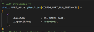

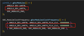

Hi Anil,
In order for SOC UART4 to work, from RTOS SDK besides
and initialize the pinmux, anything else I need to do?
Dazong
Hello Dazong,
Before the UART initializations, we need to do Pin Mux and Clock enable is fine.
Anil.
