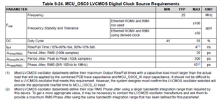

Customer wants to know if there is a duty cycle requirement of Crystal on AM62x family?

I assume the question is for external oscillator:
Please refer below.
This is for AM62P, the same is valid for AM625 and the data sheet will be updated.
