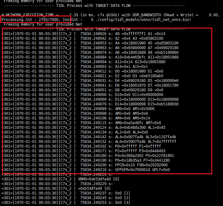

We encountered exceptions when looping through file reads for inference using the original SDK for testing.
Sometimes it prints exceptions similar to register errors, and sometimes the program simply freezes without any feedback.
In most cases, exceptions occur when the process of reading data -> performing TIDL inference -> saving data is looped around 3000 times.
However, if the program only performs a looped read test on a single image, it works normally.
The demo I run is TI_DEVICE_armv8_test_dl_algo_host_rt.out whic compile in  c7x-mma-tidl/arm-tidl/rt

  • Hi Guang,
    Are you opening and closing ort::sessions between runs?  A memory leak can happen in this situation.
    Additionally, here is what I will need to accurately debug this.
    • What rev of SDK/TIDL are you using?
    • Is this on the host or device?
    • A zip file of the .bin files from test_east_single.txt, I assume they are inputs, and listing them out in the text  only tells me there is something missing
    • How you run this on the PC and the device (command line invocation)
    • What was modified in tidl_tb_utils?
    • What is meant by "However, if the program only performs a looped read test on a single image"?  Are you reading the same image over and over or do you save a copy of the image in memory and re-run it.  Also please provide the command line on how you run this.
    Chris

  • Hi Guang,
    Would it be possible for you to capture the values in the IEER and IEAR registers?  In the initial screenshot, the values may have been printed below what was captured in the screen capture.  A log output may be better than a screen capture for debugging purposes.

  • Register_print.log
    This is all the register print log
