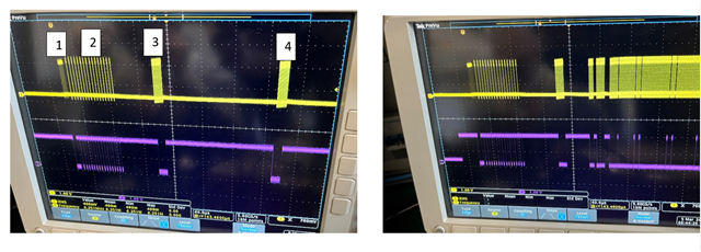

Just burn tiboot3.bin to AM6442 board but can not successful boot up. Below is the wave we compare with EVM board.
left side is customer board OSPI data0 line input, right side is EVM board is EVM board XSPI boot wave.
stage1/stage2/stage3  believe customer board is same as EVM board. but from stage 4 customer board do not load more tiboot3.bin image to SRAM.

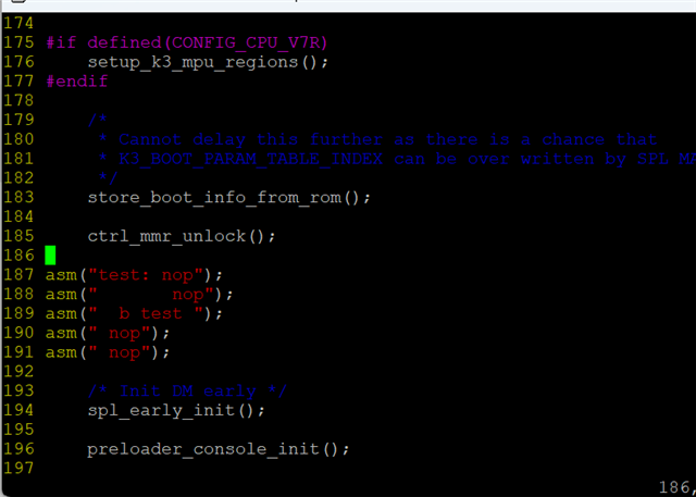

the tiboot3.bin we has verified through DFU and it can enable LPDDR4 successful. customer AM64 use DFU can enter uboot mode.
sf read burned OSPI flash image, compare with EVM sf read 0x82000000 0 0x1000 the data is same. We believe u-boot burn to OSPI image is right.
Only different is EVM board is single die OSPI. customer used 2-die OSPI flash.
Could you please confirm whether AM64x support 2-Die OSPI flash?
