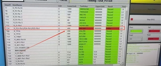

Since the AM5728 chip has been failing before, we have added impedance testing of the main functional network in the production stage to ensure the conformity of the product before delivery. In the most recent production, an AM5728 was found to fail the impedance test, and the results are shown in Figure 1.Figure 1

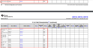

After removing the AM5728 from the circuit board, the corresponding 3.3V network pin was measured, and it was found that the overall 11 3.3V network pin impedances were low. 3.3V network pin schematic, as shown in Figure 2. The test impedance difference is shown in Figure 3Figure 2Figure 3
