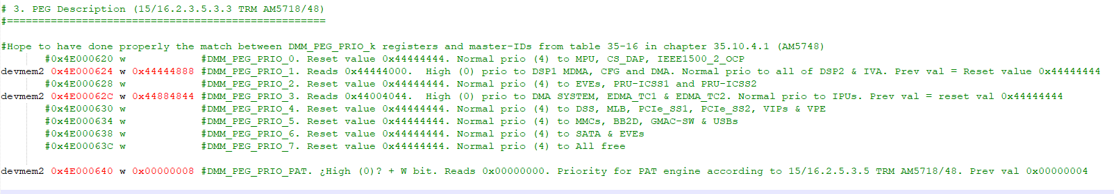

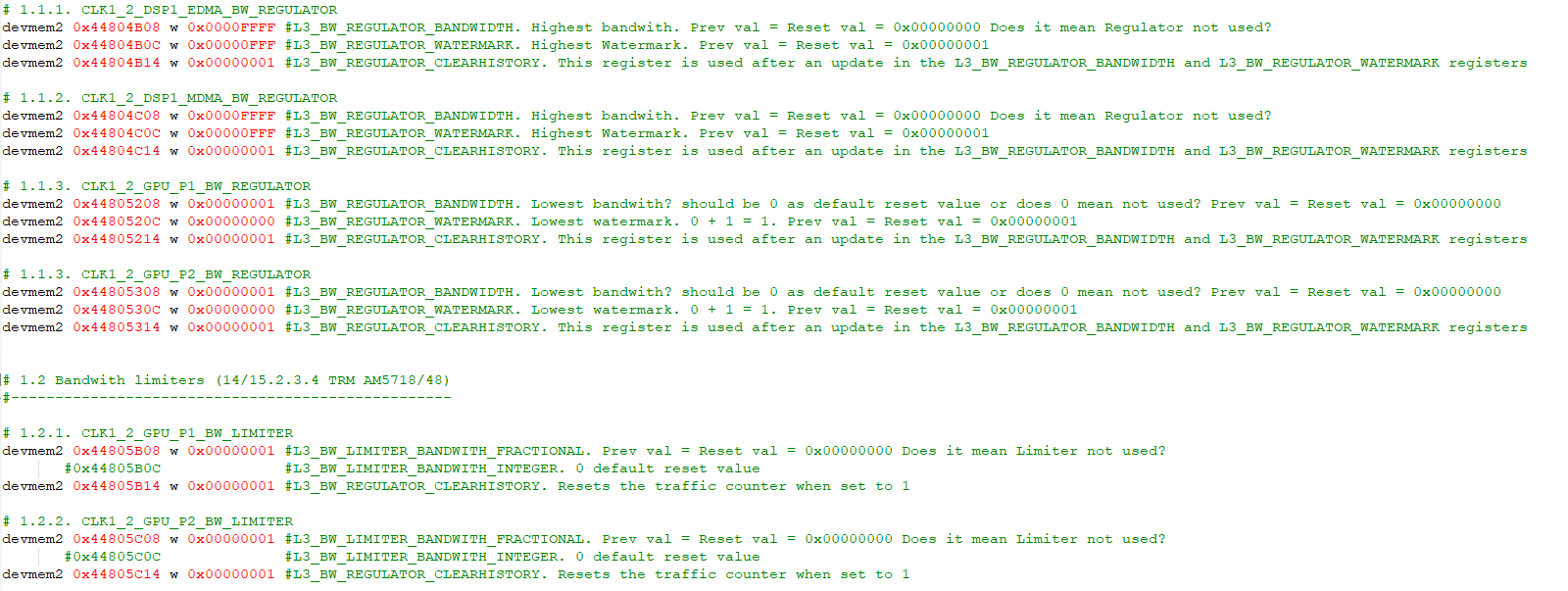

    I've tried the following but didn't seem to avoid the problem. Please let me know if I've done something wrong:
    I've tried also "touching" SDRAM & L3_Main Initiator priority registers, PEG priorities, DSP NoC Arbitration and DMM Emergency, none worked Pensive
    I will write what I did on following posts
    I couldn't get to understand how to use class of service priorizing just the DSP or the DSPs + IPUs. Haven't been able to see masterID+mask combination or priority just for them.
    Thanks for the support

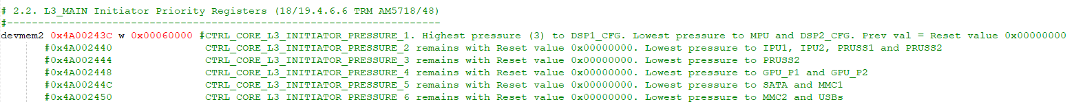

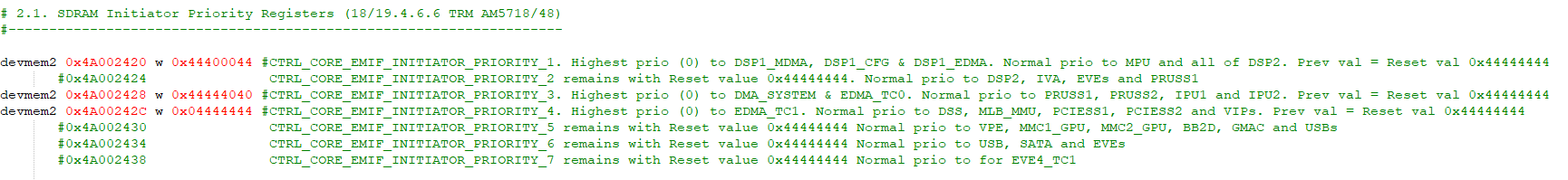

    Let me share you other "options" I've tried in order to give a more complete information to the GPU dev team. So, apart from the BW Regulators and Limiters from my previous post, I tried:
    Initiator Prioriry Registers
    DMM PEG Priorities
    DSP NoC Arbitration
    DISPC MFLAG
    MFLAG Override
    With all this changes, it seems that the GPU affects the DSP less than with default values, but it still happens sometimes.
    So, I would be very grateful if the GPU dev team or anyone could share any hint or help to avoid this. Or if someone sees an error on the values of the registers, or maybe if we have to do it in a proper order, in a proper stage of the booting or whatever...

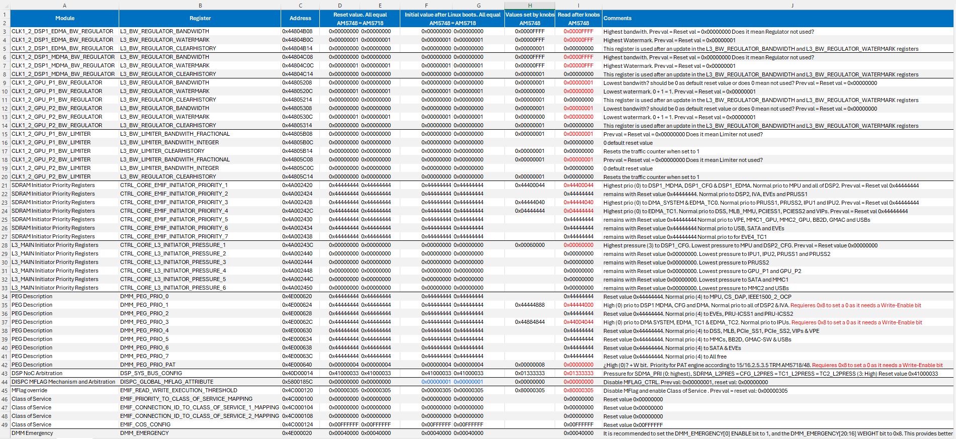

    Actually, I followed sprabx1a along with the TRM to use all the knobs mentioned in my previous posts, and you are right, we are running linux on A15 core(s). Specifically Yocto Dunfell, kernel 5.10.100-rt62, SDK 08.02.01.00.
    Following your suggestion, I've checked the register values at reset (taken from TRM), after linux boot and after applying the knobs.
    TRM reset values are the same for both AM5718 and AM5748. Columns D and E in the picture below.
    Register values after linux boot are also the same for both AM5718 and AM5748 (Columns F and G. And the only register with a different value from reset values is  DISPC_GLOBAL_MFLAG_ATTRIBUTE which has the MFLAG_CTRL activated (by the GPU driver I guess).
    You can see it in blue color in the following picture, along with the registers that are changed (red, column I) after applying knobs (column H).
    I'm open to change any other registers or values of the mentioned registers. We would appreciate light and orientation from the Dev team in case we are doing something wrong or lacks something else.

  • Hello Ro,
    I haven't had much bandwidth on my side and Dev teams only advice was to turn on these knobs until you get the results needed for your application.
    The feedback was that it takes some experimentation.
    Other feedback was more of a system level question. From your application, are you capping the Framerate? That is to say, if you lower the framerate does the issue still present itself? does it get better?
    -Josue
