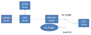

TDA4VL-Q1: How to switch display image for single cam application?
Part Number: TDA4VL-Q1
Hi Expert,
We have an application modified from single cam example. And it has the architecture like this:
figure1
Now we hope to swith display image if application gets special condition, like this:
figure2
For this purpose, we replace the vx_image with one vx_object_array (two vx_images included) in figure1. In app_create_graph(), we put MOSAIC node output to first channel in this new vx_object_array. And we load status condition image to 2nd channel in this new vx_object_array. In app_run_graph(), system will check system status and send TIVX_DISPLAY_SELECT_CHANNEL to switch display image. For testing, we set a abnormal stauts, and we expect it show a status image, but it show a flicking result: system display real camera image & black image ony by one with OPENGL error:
