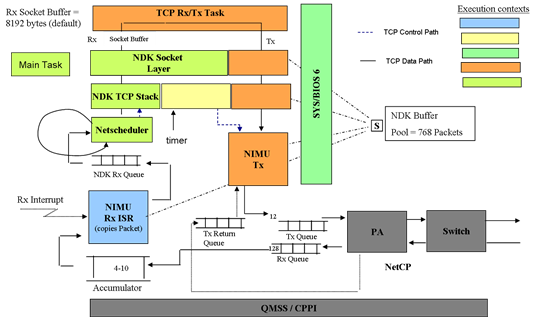

Dear All:
I am testing the evm6678l board eithernet speed.
I copy the demo in mcsdk "hello world" demo in location "c:\program files\Texas Instruments\mcsdk_2_00_01_12\examples\ndk\helloWorld".
this demo contains a udp server.
I modified the demo to a tcp socket server so that I could send data to another machine constinually.
However, the client machine received data only around 10 M-Bytes/s, which means there is only 100M-b/s eithernet.
The cable is connect directly from 6678evm board to the client PC. the PC indicates the connection is a 1G connection.
I tried with another PC that the client program can run on 600M-bit/s so the client is not the reason.
So I think there may be some reason the 6678 could only run on a 100 M-bit/s mode ?
  • Does not any one know the answer?
  • Lucifar,
    You will likely need to tune some parameters to get more performance with the system (I did when I was doing line rate testing with a smartbits/iperf on the MCSDK). The default out of the box values are a bit low I think. Since this is TCP with some modifications you should be able to get around the following performance. With iperf and some tweaking we were able to transmit ~920 Mbits/sec @ 1514 packets and a 4K window size. Receive was around 482 Mbits/sec with the same packet size and window size as transmit.
    I am not sure what version of MCSDK you are using but you should get the latest release which is 2.04. This has some tweaks for performance for receive queue and the NIMU driver and fixes a receive bug when it runs out of buffers.
    For reference look at the following diagram (I believe this is mostly correct):
    The key areas to tweak are 1.) the Rx queue between the PA and NIMU driver 2.) The number of NDK buffers and 3.) possibly the Rx Socket Buffer size.
    In release 2.04 the number of Rx Queue buffers was raised from 18 to around 120 something (I don't recall offhand) so with 2.04 you do not need to make this tweak yourself.
    To increase the number of NDK buffers you will need to re-build a file called pbm.c which is in the NDK directory packages/ti/src/os.  I believe there are instructions on the wiki on how to re-build NDK. You need to change this value: #define PKT_NUM_FRAMEBUF    192  The default is 192. I think I increased it by a factor of 6.

  • Thank a LOT for your kindly infomation.
    And yes, I do need some time to get understand the whole.
    Well, I am using the NDK 2.20.4,  PDK 1.0.0.12, MCSDK 2.0.1.12.
    Yes the performance is very important, and I hope the future package will need fewer tweaks.
    Well, for my question, some one else told me it may caused by the cache setting but not so sure.
    I checked the setting that the program seems running in L2SRAM and I am now tying to move it out (maybe I don't need?).

  • Hi Jack:
    Thank you very much!
    After installing the 2.04 MCSDK, now the speed is around 650 M-bit/s. Now it's at last a reasonable speed.
