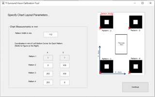

I think that the algorithm should not care about the actual size of the chart (in millimeters), but only about the number of pixels (maybe 20pixel, or 40pixel?) the chart occupies in the camera image
For example, the black square of my chart is 112mm and the chart position is shown below:

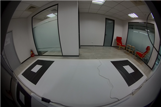

Here is one of the camera view (1920x1080):
I just wonder what is the minimum pixel of the black square in the camera view is allowed to do surround view calibration and would work.

Hello Joy,
There is no actual limit on size of the squares. They can be as small as needed as long as you can manually select the points on the square used for calibration. In the older devices this was done through MatLab. However, having larger squares will help the calibration and provide more accurate output images.
