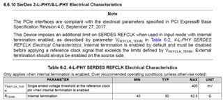

My question is about SERDES_REFCLK input pins. There are some constraints mentioned in the datasheet that I don't understand at all
  • It is said that an internal termination exists by default. I guess that default means "at power up" .
    • is this Correct ?
  • If we use SERDES for booting purpose, for example PCIE, or else this requires SERDES_REFCLK to be alive before SOC starts executing ROM code.
    • Is this Correct ?
  • Therefore we MUST respect the table 6-2. The problem is that I don't understand the meaning of "threshold" in that case.
    • Does this mean that none of the _P and _N signals should exceed 400mV ? which would limit peak-to-peak differential voltage to a very small quantity, for example Vol=0.1V and Voh=0.3V
    • Does this mean that _P  must be >0.4V (while N_being < 0.4V) in order to be seen as '1' ?
    • It is not clear to which characteristic this constraint applies to. Could you explain please.
  • The table introduces the internal RTERM value. I guess that this refers to the load that each _P and _N signal sees.
    • Is this correct ?
  • I understand that the internal termination can be disabled.
    • How is this performed ?
