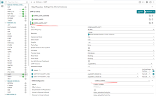

OK, Let me describe the process.
As previous email we discussed, I try to configure the 1BCDMA and 1UART PKTDMA according to your suggestion (https://e2e.ti.com/support/processors-group/processors/f/processors-forum/1485815/am6421-bcdma-and-pktdma-configuration-problem/5711608#5711608). And it succeed.

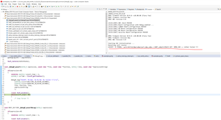

However, after I add another UART with PKTDMA(totally 2 PKTDMA and 1 BCDMA), shown as follows:
when I run it, the same phenomenon as the beginning shown as follows:
so can you help me reproduce it and find the root reason.
thank you!

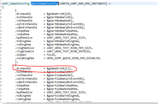

I found the root cause of the issue and the generated code creates an issue.
I have raised bug internally to fix this issue in the MCU+SDK ..
In the generated code, for two UART DMA channel config, the PKTDMA instant supposed to be same.
But here the generated code creates two PKTDMA instants, which creates an issue.
To fix this issue, follow the steps :
1. include.h file and extern variable as below to fix the compiler issues .
#include <drivers/uart/v0/lld/dma/udma/uart_dma_udma.h> extern UART_UdmaChConfig gUartUdmaChConfig[CONFIG_UART_NUM_DMA_INSTANCES];
2. Next, add the code below exactly before the drivers open.
gUartUdmaChConfig[1].drvHandle = &gUdmaDrvObj[0];
3. Compile the code and Load it from CCS
Please let me know if an issue is still present after adding these changes.
#include <drivers/uart/v0/lld/dma/udma/uart_dma_udma.h> extern UART_UdmaChConfig gUartUdmaChConfig[CONFIG_UART_NUM_DMA_INSTANCES]; gUartUdmaChConfig[1].drvHandle = &gUdmaDrvObj[0];
