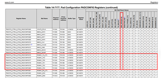

Following taken from AM62 TRM:
Please assist us modifying these pins - RGMII1 drive strength
Typically pins that are marked reserved are not supported. I will check into if that is case here.
Schuyler
I confirmed with a hw apps engineer that this register setting is not supported. Pins that are marked reserved are not supported and therefore should not be changed.
Schuyler
