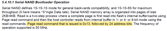

AM625: Question for Serial NAND boot flow
Part Number: AM625
My customer has a few questions for Serial NAND boot.
Below is TRM section 5.4.10.1.
Q1) Does bootloader check BUSY bit after the Page read command?
Q2) If an answer to Q1) is YES, which command (and format) is used?
Q3) If an answer to Q1) is NO, how much waits are inserted after the Page read command?
Q4) Do you have any specific QSPI NAND part number(s) compatible with AM62x?
