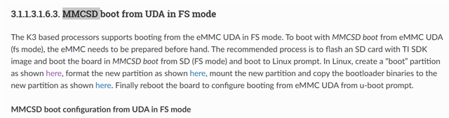

  • Tony,
    For AM62L :
    texasinstruments.github.io/.../UG-Memory-K3.html
    The recommended method is to flash and boot eMMC with MMCSD boot from UDA in fs mode.

    #2. I tried eMMC FS mode according to the procedure to fdisk UDA to two partition, mkfs mmc0blk1 to fat format, copy tiboot3.bin, tispl.bin u-boot.img from sd card to mmc0blk1, reboot to UBOOT to set:
    3.1.1.3.1.6.4.3. Boot from UDA
    => mmc partconf 0 1 7 1
    => mmc bootbus 0 2 0 0
    Set boot mode to [0:15] : 11000011 0000 0000 , power up can only boot up with below log, the log is same as DFU boot with default tiboot3.bin. Does it need patch to support eMMC UDA FS boot?

    #3. Is the sector name wrong? MMCSD should be eMMC? if yes, hope it be corrected right there, no need to wait next release, and leave the error there forever.

  • My boot mode is 0xC3, should be yours 0x43.
