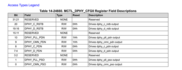

AM62P-Q1: MIPI DSI D-PHY doesn't seem to be clocking.
Part Number: AM62P-Q1
Other Parts Discussed in Thread: AM62P, TFP410
We are integrating a DSI panel (using a Himax hx8394 bridge chip) to the DSI output of an AM62P.  The panel is a 720x1280 RGB888 supporting 60 Hz.  I am using the ti-linux-6.6.y branch consistent with the linux processor SDK 10.1.
We are using panel control / timings code from a mature design.  I know that the AM62P DSI is working in LP / command mode as I can program the bridge chip properly and cause it to generate test patterns on the display and I can properly control the backlight, etc.  I can also read back several registers including the panel ID, etc., and all of those commands work as expected.
However, using the kmstest or manipulating the framebuffer results in a blank screen when the system should be transmitting HS video data.  It appears that there is no MIPI DSI clock / data running on the interface, even though the framebuffer / kmstest reports a proper frame rate and active display, etc.  This problem looks very similar to this thread : https://e2e.ti.com/support/processors-group/processors/f/processors-forum/1464278/am62p-q1-there-is-no-display-when-setting-display-resolution-1920x1008-w-dsi/5642166#5642166.
We have tried cutting the framerate down to 30 Hz, as the mentioned thread suggested that lower clock rates would work.
Here are the results from modetest -D 30220000.dss:

When running the kmstest (reporting 60 Hz output rate) and pausing it, and inspecting the clocks, it looks like the dsi_p_clk is not running (231:2) and I don't see any clock that is running at the calculated HS_CLK_RATE (373788000 Hz) that the cnds drivers come up with for the number of lanes and display resolution.
kmstest --flip --device="/dev/dri/card0"
[  397.372136] cdns-dsi 30500000.dsi: Computed HS_CLK_RATE = 373788000

    I went and got a high speed scope.  I am now able to see a continuous ~186 MHz clock on the clock lane, which seems correct if it is a DDR interface.  But all of the data lanes appear to be in the Low Power state (there is no activity I can see with the scope) at about 1.8V, almost like they are powered down or stuck in reset.
    When I look at the MCTL_DPHY_CFG0 register:
    root@mitysom-am62px:~# k3conf read 0x30500010 32
    | VERSION INFO                                                                 |
    | K3CONF | (version 0.3-nogit built Thu Jul 25 14:13:02 UTC 2024)              |
    | SoC    | AM62Px SR1.0                                                        |

    Value at addr 0x30500010 = 0x1f03f1
    It looks like all of the lanes are powered down?  Though the TRM is unclear about the use of these bits:
    The value of 0x1F03F1:
    DPHY_CMN_PSO is enabled
    DPHY_PLL_PSO is disable
    DPHY_D_PDN, DPHY_C_PDN, DPHY_CMN_PDC are all set high.  Is this Powered Down, or Powered on?
    DPHY_PLL_PDN is set low.  Is this powered down, or powered on?
    It looks like all of the clock and data pins are out of reset (assuming RSTB means active low, but it's not well documented).
    Any suggestions to try to get the DPHY data lanes to start pumping data is welcome.

  • When I look at the MCTL_DPHY_CFG0 register:
    This is what I see:
    root@am62pxx-evm:~# k3conf read 0x30500010 32
    | VERSION INFO                                                                 |
    | SYSFW  | ABI: 4.0 (firmware version 0x000a '10.1.8--v10.01.08 (Fiery Fox))') |
    Value at addr 0x30500010 = 0x1103f1
    root@am62pxx-evm:~# k3conf read 0x305000F0
    | VERSION INFO                                                                 |
    Value at addr 0x305000f0 = 0x1
    root@am62pxx-evm:~# k3conf read 0x30500140
    | VERSION INFO                                                                 |
    Value at addr 0x30500140 = 0x0
    MCTL_DPHY_CFG0 value is correct since bits [19:16]=0xf implies all 4 lanes are asserted to work.
    DSI_VBUSP_CFG_DSI_0_DSI_VID_MODE_STS (0x305000F0) value is still 0x1 for me.
    DSI_VBUSP_CFG_DSI_0_DSI_VID_MODE_STS_CTL (0x30500140) is 0x0 same as yours.

    I can provide datasheets, etc. for the panel.  But I can't see how to attach files here.  Send me a way to send PDFs and I will supply them.
    We have tried on a separate branch to incorporate the other drm changes you pointed to, but the behavior was the same, so it's not clear if that really helped or not, and I'd rather work from your released TI SDK if possible.
    I am also open to checking the hardware design.  But, given we can control the panel over the LPM on channel 0 and put the panel into test mode, I don't think anything is wrong with the connections.  My only thought might be is there is a PLL or something in the 62P that isn't locking because of a rail or something.  But I need help to isolate that kind of issue.
    Please let me know if you need additional information.
