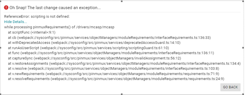

My Customer ran into an issue while configuring the clock settings in sysconfig. This issue only happens with v1.23 and does not appear in v1.22 . This is the we see:
Is this a sysconfig issue?

    Each version of the FreeRTOS SDK has its dependency on certain version of the CCS, SysConfig, CGT tools. It is specified in its release notes. Here is the FreeRTOS SDK for AM275x 10.01.00.32:
    AM275 FreeRTOS SDK: Release Notes 10.01.00
    Dependent Tools and Compiler Information
    Tools/ Component Supported CPUs Version
    Code Composer Studio R5F, C75 12.8.1
    SysConfig R5F, C75 1.22.0, build 3893
    TI ARM CLANG R5F 3.2.0.LTS
    C7000-CGT C75 4.1.0.LTS
    FreeRTOS Kernel R5F, C75 11.1.0
    TIFS NA v10.01.09
    It specified the SysConfig version is 1.22. Please use the correct version of the SysConfig as it specified in the release notes.
