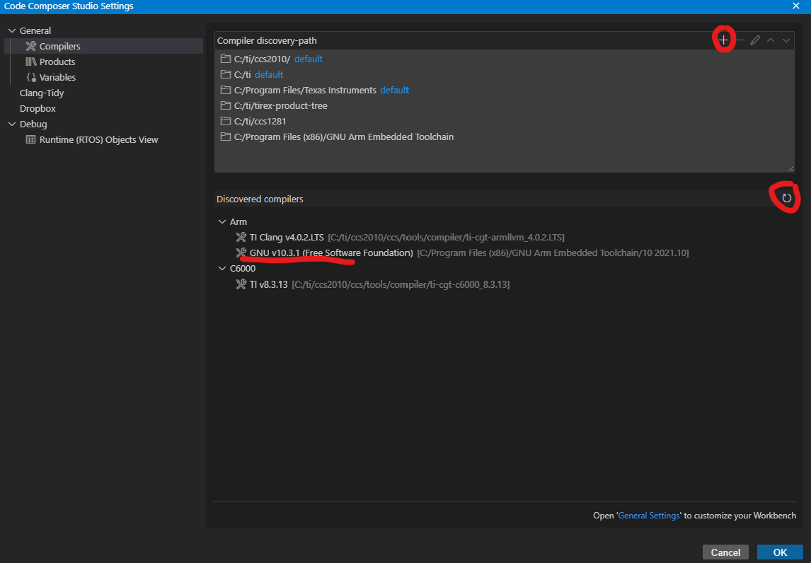

    Regarding the arm gcc compiler. I couldn't find a download option as it was implemented in CCS 12.1 but you can manually download the arm gnu toolchain: https://developer.arm.com/downloads/-/gnu-rm and install it. Then you can add the compiler in CCS 20.1 under File -> Preferences -> Code Compoer Studio Settings -> General -> Compilers. You need to first add the installation directory of the compiler as compiler discovery path and then click on the discovered compilers reload icon to update the list. With this I was able to import a gcc project and compile it.

  • Hi again,
    So, I installed the latest GCC kit arm-ggc 14.3 into /armgcc directory.
    I then added a compiler via file->preferences->general->compilers by adding a compiler discovery path
    of /home/webjorn/armgcc/
    I then click on the little icon right of discovered compilers, but no compilers are found.
    I tried traversing the directory structure but CCS does not find any compilers.....

  • Hi Gullik,
    I tried it with this version and it worked: https://developer.arm.com/-/media/Files/downloads/gnu-rm/10.3-2021.10/gcc-arm-none-eabi-10.3-2021.10-aarch64-linux.tar.bz2?rev=b748c39178c043b4915b04645d7774d8&hash=572217C8AFE83F1010753EA3E3A7EC2307DADD58

  • Hello again Theo,
    I have managed to get the GCC tools working, I probably selected the wrong kit file.
    I am running the arm-gnu-toolchain-14.2.rel1-x86_64-arm-none-eabi and the project compiles.
