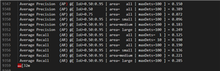

  • Hello SIr, to my surprised, this week monday my colleague rebooted the pc and then it works fine. I don't understand why but it is what it is. Now 'TIDLExecutionProvider', 'TIDLCompilationProvider', 'CPUExecutionProvider' all available and can be used. Anyways thanks for your reply.
    Now at least the artifacts can be generated successfully.
    Now the run.log looks like that (please refer to the attached) . Please voice out if you find anything that is potentially bad
