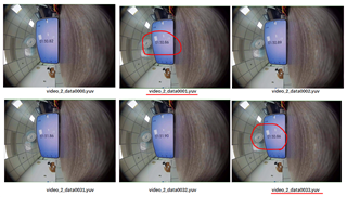

We are using am62p5 with SDK10.0. There are 4 cameras. The schematic diagram of the MIPI data stream is as follows:
We simultaneously open 4 device nodes(/dev/video2~5) and save continuous frame data. We found that frame data obtained from the same camera may be duplicated.
For example, we saved 34 consecutive frames of images from the /dev/video2 node (video_2_data0000. yuv to video_2_data0033. yuv), the Video_2_data0001.yuv and video_2_data0033.yuv are the same image.
The attach file is the source code that we are using for test.

Please help us to analyze the issue.
