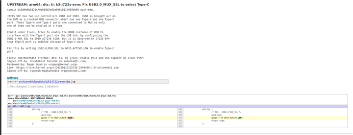

I'm wanting to test flashing an image using super speed in u-boot on AM67.
All of the code is written as if it should support usb 3.0, but the device is automatically switching down to 2.0 speeds.
I'm using the AM67 EVB, so wanting to understand if this is possible?
From the EVB documentation, it says it defaults to 2.0. I tried manually setting the pin to switch the mux to 3.0 speeds, but lost communication.
