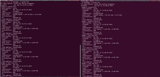

  • One more thing I would like to mention, the above successful logs are coming from ti_sci_cmd_proc_auth_boot_image()::drivers/firmware/ti_sci.c, where ti_sci_cmd_proc_auth_boot_image() returns success for tiboot3 and tispl images.

    Nevertheless, I would suggest you to compare the contents of this 9.2 sysfw.itb against the previous 8.1 SDK. You can check on the image size as well as the contents using the U-Boot's dumpimage utility.
    regards
    Suman
    sdk9.2 :
    1.3.6.1.4.1.294.1.3=ASN1:SEQUENCE:swrv
    1.3.6.1.4.1.294.1.34=ASN1:SEQUENCE:sysfw_image_integrity
    1.3.6.1.4.1.294.1.35=ASN1:SEQUENCE:sysfw_image_load
    1.3.6.1.4.1.294.1.4=ASN1:SEQUENCE:encryption
    1.3.6.1.4.1.294.1.1=ASN1:SEQUENCE:boot_seq
    1.3.6.1.4.1.294.1.2=ASN1:SEQUENCE:image_integrity
    sdk8.1:
    Content wise:
    Thanks in advance.
    Kishore
  • Hi Kishore,
    We are trying to understand if the issue points to any changes in the SDK 9.2 sysfw.itb, particularly if it demands additional OIDs or requires a specific order of OIDs to successfully validate.
    The required OIDs are all fixed for a given binary, so this is not an issue, and no additional OIDs are required for 9.2 sysfw.itb.
    Here are the details we observed:
    Thanks for the detailed notes.
    However, when flashing sysfw 9.2 in the SDK 9.2 software, all images passed initially, but when sysfw 9.2 itself was validated, we encountered an MBOX error. This led to subsequent failures for other images that had previously passed validation.
    The mbox error is a result of not getting a response properly. This is usually a result of the MCU R5F core entering an exception. Once this error is encountered, the TI-SCI protocol is non-functional, and all subsequent TI-SCI messages will be non-functional (not limiting to just the authentication of further images you are testing).
    Given that you are performing an authentication step through Linux, the TI-SCI request is routed through the MCU R5F firmware. What firmware do you use on MCU R5F, it appears that there is an issue with your SDK 9.2 MCU R5F firmware.
    Additionally, we tried removing the encryption OID in the SDK 9.2 software as sdk8.1 also not having it, but this caused the board to fail to boot.
    TIFS firmware is the primary Security Root-of-Trust firmware, and is an encrypted firmware. So, you cannot remove this OID, that is needed to decrypt the firmware.
     The difference between Point 2 and 3 is the order/sequence in which the firmware images are validated.
    Your table does show the 8.1 sysfw.itb file also failing in Point 2.
    Does the SDK 9.2 sysfw.itb require additional OIDs or a specific order of OIDs to be validated correctly?
    No
    Is there a mandatory list of OIDs required for the proper functioning and validation in SDK 9.2?
    This is not an issue with OIDs.
    Content wise:
    Thanks for this dump. Overall, nothing stands out. The 9.2 sysfw.itb files/contents are slightly larger, and this comes due to the increased size differences in certificates coming from OpenSSL 3.x on the newer Ubuntu 22.04 machines that SDK 9.x is released with.
