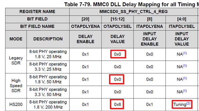

#1. Before SDK10.1, UBOOT and Kernel dtsi sdhci0 parameters all use same parameters, but doesn't follow datasheet.
	sdhci0: mmc@fa10000 {
		compatible = "ti,am62-sdhci";
		reg = <0x00 0x0fa10000 0x00 0x1000>, <0x00 0x0fa18000 0x00 0x400>;
		interrupts = <GIC_SPI 133 IRQ_TYPE_LEVEL_HIGH>;
		power-domains = <&k3_pds 57 TI_SCI_PD_EXCLUSIVE>;
		clocks = <&k3_clks 57 5>, <&k3_clks 57 6>;
		clock-names = "clk_ahb", "clk_xin";
		assigned-clocks = <&k3_clks 57 6>;
		assigned-clock-parents = <&k3_clks 57 8>;
		bus-width = <8>;
		mmc-ddr-1_8v;
		mmc-hs200-1_8v;
		ti,clkbuf-sel = <0x7>;
		ti,otap-del-sel-legacy = <0x0>;
		ti,otap-del-sel-mmc-hs = <0x0>;
		ti,otap-del-sel-ddr52 = <0x5>;
		ti,otap-del-sel-hs200 = <0x5>;
		ti,itap-del-sel-legacy = <0xa>;
		ti,itap-del-sel-mmc-hs = <0x1>;
		status = "disabled";
#2. In SDK10.1, UBOOT still use upper/old parameter. Kernel dts updated as below to follow datasheet.
Questions:
#2.1 Why UBOOT use different tap delay parameter which doesn't follow datasheet but still can work at HS200.
#2.2. Why Linux must use tap delay value as datasheet, is it the major factor fixed the issue? or just update it to follow datasheet? but forgot to update UBOOT dts fil?

    The TAPDLY value update in kernel devicetree was along with the kernel sdhci_am654.c driver update, but we have update the U-Boot sdhci driver yet (given we haven't got any U-Boot MMC issue report), so U-Boot still uses the old values.
    I will look into the sdhci_am654.c patch difference from the referred e2e thread and SDK10.1 and get back to you later.

    As discussed offline, instead using the patch from the referred e2e thread, please ask the customer to test the following two kernel patches taken from SDK10.1.
    https://git.ti.com/cgit/ti-linux-kernel/ti-linux-kernel/commit/?h=10.01.03&id=5bc0054f6e8f93be56a5cf2570e9db9d40f5d665
    https://git.ti.com/cgit/ti-linux-kernel/ti-linux-kernel/commit/?h=10.01.03&id=32ae7316ddc6d9b6bb0d87706cf7daa44c4c1e92
