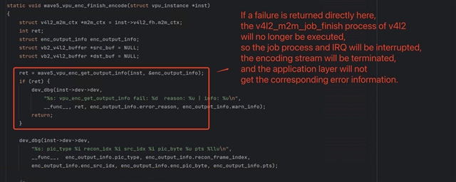

hi, experts:
We use the ioctl of the system to encode video streams and find a phenomenon that the input queue of vpu will overflow, and the encoder has no stream output at this time, and will not recover by itself.
There are two scenarios in which the queue overflows:
1. Put the board into a high temperature box, and when the temperature rises to 85℃ (SOC actual temperature to 105℃), the coding queue will overflow
2. At room temperature, if the image screen is loaded and the coding rate increases, the queue overflow will also occur.
Here are the problems we found with the wave5 drive:
Attached is the vpu register information we dumped:
