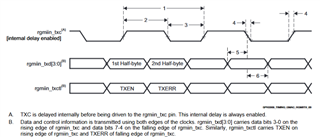

My query is regarding RGMII interface in AM5279 processor.To acheive the Txc of 0.75ns, what is the recommended trace length of RGMII interface and any termination was included in this measurement ?

Muktha,
For the TXC, the internal delay is always enabled, and for the RXC, it will have to be externally delayed (either with the PHY side Internal delay or board delay).
Also, the board propagation delay mismatch must be within 50ps, as recommended.
All the setup and hold time must be simulated to ensure the RGMII specs are met.
