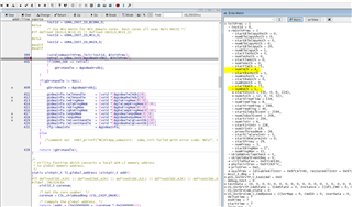

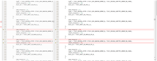

        After I looked at teh MCAL driver, I was trying to configure the second UDMA channel, it failed at configuring second RX udma channel,
    I found it was assigned 4 channel for TX, but only 1 RX channel(see below screenshot). I would like to know if it is configured in sciclient_defaultBoardcfg_rm.c. I was trying to change the file (see attached code) to configure 3 RX channel, but it seems not affect it. by the way, my code runs on MCU2_1
    Yes the udma channel count is configured in sys config. You need to modify the resource in sysconfig tool and generate all the required files.
    Tarun Mukesh
  • Thanks, I will try it.

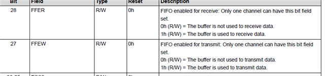

       The function multi-channel MCSPI with DMA is working, but it is not we expected, I have some questions:
    we configured datasize is 16 bits,
    1.  it will switch to next channel after transfer 16 bits even we would like to transfer 32 bytes data for each channel, is there way to configure like after transferring 32 bytes data, then switch to next channel.
    2. we would like to transfer 32 bytes data for each channel, each DMA trigger, each channel only transfers bits data, it stops, it is correct or can be configured as we expected:
    like 16 bits data transfer of channel 1  ->(switch) ->16 bits data transfer of channel 2 -> (switch)-> 16 bits data transfer of channel 3-> (switch)-> 16 bits data transfer of channel 4->stop
    we expect:
    16 bits data transfer of channel 1  ->(switch) ->16 bits data transfer of channel 2 -> (switch)-> 16 bits data transfer of channel 3-> (switch)-> 16 bits data transfer of channel 4->next 16 bits data transfer of channel 1(switch) -> next 16 bits data transfer of channel 2 -> (switch)-> next 16 bits data transfer of channel 3-> (switch)-> next 16 bits data transfer of channel 4->....until 32 bytes data complete transfer
    3. according to data sheet, it will switch "Rule 1: Only enabled channels (the MCSPI_CHCTRL_0/1/2/3[0] EN bit) can be scheduled for transmission
    and/or reception", but what I observed: it will switch even MCSPI_CHCTRL_0/1/2/3[0] EN bit is not set, but the bit of FFER or FFEW in MCSPI_chCONFIG_0/1/2/3 is set
    Jiang Liu
    Good to know that you made it working.
    If FFER  or FFEW  is set in MCSPI_CHxCONF, the channel may still interact with the FIFO, causing unintended channel switching.
    Workaround:
    Clear FFER and FFEW bits for inactive channels if you don't intend to use them.Only one channel can have this bit field set each time. See in the below register snippet as well.
    Ensure that the MCSPI_MODULCTR
    L[1] MS bit is correctly set only for intended channels.
