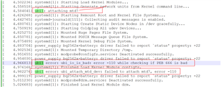

we use the gpmc nand flash and ubifs,   when  linux booting,   ubi attach partition is failed  with bad block check.  could you provide some suggestion to investigate this issue ?
below is boot log
we use  TI linux SDK  version :  10.00.07.04
thanks very much

    [09:35:41:610] [    1.678184] nand: device found, Manufacturer ID: 0xc8, Chip ID: 0xda
    [09:35:41:610] [    1.684590] nand: ESMT GD9FU2G8F3A
    [09:35:41:620] [    1.687988] nand: 256 MiB, SLC, erase size: 128 KiB, page size: 2048, OOB size: 64
    [09:35:41:620] [    1.695595] nand: using OMAP_ECC_BCH8_CODE_HW ECC scheme
    [09:35:41:632] [    1.700952] 8 fixed-partitions partitions found on MTD device omap2-nand.0
    [09:35:41:632] [    1.707823] Creating 8 MTD partitions on "omap2-nand.0":
    [09:35:41:637] [    1.713129] 0x000000000000-0x000000080000 : "NAND.tiboot3"
    [09:35:41:642] [    1.720265] 0x000000080000-0x000000280000 : "NAND.tispl"
    [09:35:41:652] [    1.727907] 0x000000280000-0x000000680000 : "NAND.u-boot"
    [09:35:41:652] [    1.736860] 0x000000680000-0x0000006c0000 : "NAND.u-boot-env"
    [09:35:41:669] [    1.743914] 0x0000006c0000-0x000000700000 : "NAND.u-boot-env.backup"
    [09:35:41:669] [    1.751492] 0x000000700000-0x000003e00000 : "NAND.rootfs"
    [09:35:41:674] [    1.791874] 0x000003e00000-0x000007500000 : "NAND.rootfs_backup"
    [09:35:41:685] [    1.832823] 0x000007500000-0x000010000000 : "NAND.app"

    [09:35:42:244] [    4.538486] ubi0 warning: ubi_io_read: error -110 while reading 2556 bytes from PEB 286:19720, read only 760 bytes, retry
    [09:35:42:244] [    4.572015] ubi1: attaching mtd7
    [09:35:42:255] [    4.618227] systemd[1]: Starting Generate network units from Kernel command line...
    [09:35:42:261] [    4.682416] systemd[1]: Starting Remount Root and Kernel File Systems...
    [09:35:42:271] [    4.694779] systemd-journald[111]: Collecting audit messages is enabled.
    [09:35:42:271] [    4.701500] ubi1 error: ubi_io_is_bad: error -110 while checking if PEB 290 is bad
    [09:35:42:282] [    4.701602] ubi1 error: ubi_attach_mtd_dev: failed to attach mtd7, error -110
    [09:35:42:288] [    4.758414] systemd[1]: Starting Create Static Device Nodes in /dev gracefully...
    [09:35:42:292] [    4.774073] UBIFS error (pid: 119): cannot open "ubi1:appfs", error -19
    [09:35:42:303] [    4.802424] UBIFS error (pid: 123): cannot open "ubi1:nvmfs", error -19

  • Let me add clarifications on my last reply.
    From your log, there's error from mtd6(ubi0)= "NAND.rootfs_backup", and more errors when attaching mtd7(ubi1) = "NAND.app"
    Have we tried attaching only mtd6(ubi0)? and successfully booted to kernel prompt?
