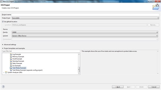

I am using CCS v5.1 and I am trying to create, build and run a SYS/BIOS project.
I have used Task Mutex example and got some build errors.
my include dirs:
"d:\ti\bios_6_32_05_54\packages\"
"d:\ti\xdctools_3_22_04_46\packages\"
but i don't know what libraries should be linked, and i got these error messages:

    The picture is pretty blurry when I try to enlarge it enough to read the device, but it looks like C66x. I opened CCSv5.1.0.09000 and tried the same thing with the EVMC6678 as my target. I was able to build the project successfully the first time without doing anything. When I right-click Properties on the test project I created, click the General item in the left pane and the RTSC tab, I see the following versions:
    • XDStools 3.22.4.46
    • IPC 1.23.5.40
    • SYS/BIOS 6.32.5.54
    The only thing I had to select was the Platform, for which I chose ti.platforms.evm6678. The project built the first time.
    So my guess is that you either have a problem with your installation or you made a wrong choice somewhere in the New Project sequence.
    The steps I went through were:
    1. New CCS Project
    2. RTSC Config Settings (I did not change any from the default, in my case):
    3. Build the project. Here is a slightly cleaned listing from the build:

  • Hi Randy,
    Thanks for your reply. I have the same environment, so I expect a very simple and clean build as you have.
    Hard/soft setup:
    TMDXEVM6678L evalution module
    CCS v5.1.0.09000
    BIOS-MCSDK 02_00_04_16
    Project steps:
    I followed these steps. I didn't add any header file or library to the project.
    Building the Project:
    I have tried the same procedure with 2 computers, but the results didn't change. When i build the projects i got the below console log,  do you have any idea?
