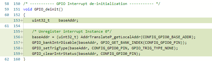

  • Hi Brody,
    Is there a way to deinit GPIO setting back to default state?
    In the GPIO_deinit we only disable the Interrupt and clear the interrupt status for the GPIO module. Also the trigger type for GPIO is reset to None.

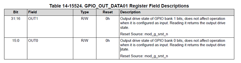

    Please refer below image.
    If you want to set the reset value for GPIO register, you can do it by directly writing to GPIO register. Please refer below image.
