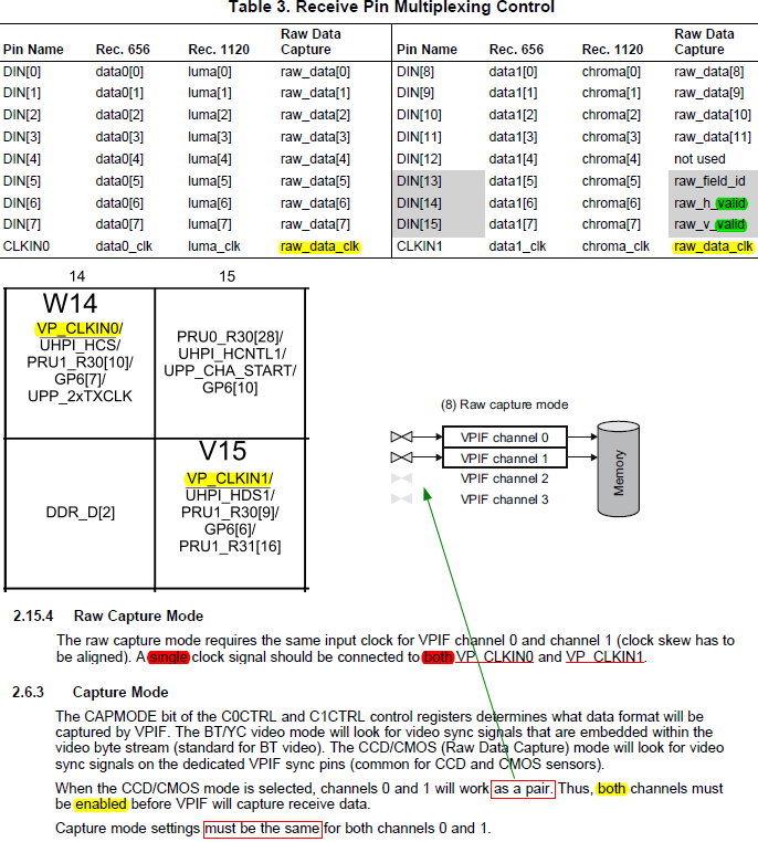

I would like to ask a question on OMAP L138 connection.
There are two input channels, and each channel has its own clock input pin {VP_CLKIN0, VP_CLKIN1}.
Raw Capture Mode
However, §2.6.3 says in raw capture mode channel 0 and 1 will work as a pair.
§2.15.4 says that input clock should be connected to both VP_CLKIN0 and VP_CLKIN1.
In ZWT package, VP_CLKIN0 is at W14 and VP_CLKIN1 is at V15. So should these two pins be tied together in PCB layout?
