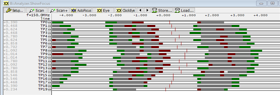

  • Hello Richard, do you have the information on TRACECLK speed of TDA4AL-Q1 and TDA4EN-Q1?
  • In my usage at room temperature I am running TDA4L's trace clock at 150MHz and TDA4VEN's trace clock at 166MHz.   This speed is higher then the data manual guarantees (which specifies a guarantee with worst cases across temperature and process).  If you target your layout to support that, you can get that or lower working.  The data is DDR in nature (using both edges) so BW estimates just 2x the clock x # of pins.   A smart trace receiver which does training and correction like LB provides is needed to work at the top speed.   I notice other more Cortex-M focused receivers only target a fraction of that speed.
    Here is an example solution used with TDA4L.  A per lane delay is used along with active termination to better center the signal to give a max eye.
